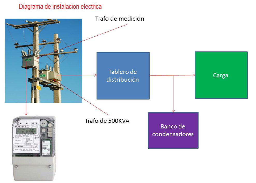

Regards... I write to you because I have problems with the power factor, the problem is that the factor that shows me on the bill is 0.3 ... as the fine is an average of what was consumed in the billing period, I asked the supplier company that will send me the energy consumption information, (kwh, kw and kvar) during the last period. When the machines in the company worked (from 8am to 6pm), the factor remains above 0.92. in the evenings and weekends it goes to 0.3. Investigate that you could lower the factor and perform a final test, with the main switch of the transformer output down and all turned off, it indicates a consumption of 0.4 power factor. I am not consuming electricity (Kw). My question is: could the 13kV / 380V traffic be damaged and somehow consume Kvar? Or could the measuring path that is found before the feed that feeds the company be damaged (the power meter of the supplying company is connected)? Thank you very much for your support... Note: at night there is only one alarm on, 4 mixed light bulbs and a server (total consumption of less than 10 Amps) Note 2: The meter has already been verified by the company. Note 3: An automatic capacitor bank is installed. Note 4: I leave a link of the very simple diagram of the installation with which I have problems: https://pbs.twimg.com/media/DQyllR_UIAEMd4Z.jpg

A doubt, the meter is connected before the transformer or after the transformer .. ??? It is necessary to know this, since a transformer in vacuum or with very little load, connected to the network, has very low power factor.

I leave you a link of the very simple diagram of the installation with which I have problems:
As additional information, the traffic is about 500KVA, the load I handle is 250A when all the machines are running, the average most used load is 60A .. and in the nights as I mentioned before, only lights and server.

From the problem posed, the compact of measurements, is taken before the transformer, so a new compensation calculation must be made when everything is disconnected, unless the FP correction bank is automatic.

Hi Ennio, the issue is not that the power factor controller is damaged, poorly calibrated or poorly designed, the problem is that with a very low load on the transformer, it maintains a power factor of 0.3 ... and with all disconnected 0,09 ... what could be the reasons? (This measurement is in the energy meter of the supplier (enel - Chile)
Ennio Montenegro.
As I mentioned before, the transformer has very bad FP when it is empty. This happens when you disconnect everything from the distribution board.
Apart from this, there is the problem that with a low load, you have a phase without load, so the bank does not correct since that phase would practically remain with FP 0 (zero).
This is because the relationship between reactive power and active power is very high. Not so in operation that as the active power increases, the ratio decreases.
My opinion is that you must leave the distribution panel connected, so that the capacitor bank is energized.
Ennio Montenegro.
And apart make a correction to the 2 phases that remain with load for the days that the plant does not work.
Another possibility is that they distribute the loads in the phases, so that the one that is left without load takes charge and so the bank can act.

Thanks YonaldoPc ... indeed the problem is that the traffic is used at a capacity of less than 15% of its nominal power ...
The most suitable solution is to calculate the invoice of how much KVAR I need to compensate, place it in the secondary of the traffic without it being controlled or measured by the capacitor bank.
jehan
jehan
2
Thanks to the comments of this Post, place a capacitor calculated to correct the FP of the traffic (which I remind you that it works at less than 10% of its capacity). This 30KVR capacitor is placed in the secondary of the transformer before the capacitor bank, so that it corrects the power factor produced by the transformer and the capacitor bank is responsible for correcting any variation of the additional inductance that can be charged in the system .
