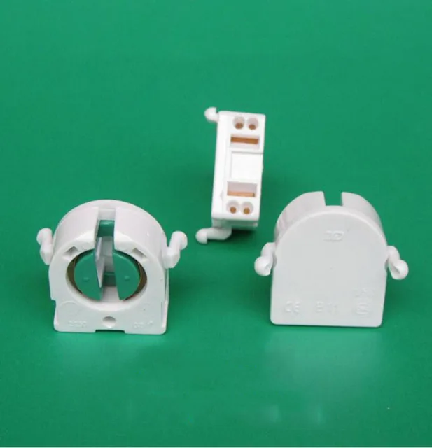

Hello, can you help me with these questions ?: -In the fluorescent lampholders I see that there are 4 holes through which to put the cables, two on each side: https://ae01.alicdn.com/kf/HTB15UT8JVXXXXbKXXXXq6xXFXXX1/Led-T8-fluorescente-portal-mparas-del-faro-parrilla-T8-tubo-led-Bases-10-unids.jpg_640x640.jpg Why are there 4? It doesn't matter where the cables connect whenever they are on different sides? -Do LED tubes have polarity? If it connected around it would it break down? -To fix the luminaire to the ceiling apart from those with 2 nuts with which it is fixed to the ceiling is it advisable to put something else? I have the "no more nails" glue out there, do I put any of that on it or not?

Hello although there are 4 holes, there are no 4 contacts there are only two with 2 inputs each to use either one or the other. They come this way to connect several lamps in parallel (garland system) even though this system is now prohibited The lamps do not have polarity with respect to the alternating current, the polarity of the led is set by the internal source not only is it not necessary but it is not advisable to place glues, only the predefined fixing system is sufficient Regards
