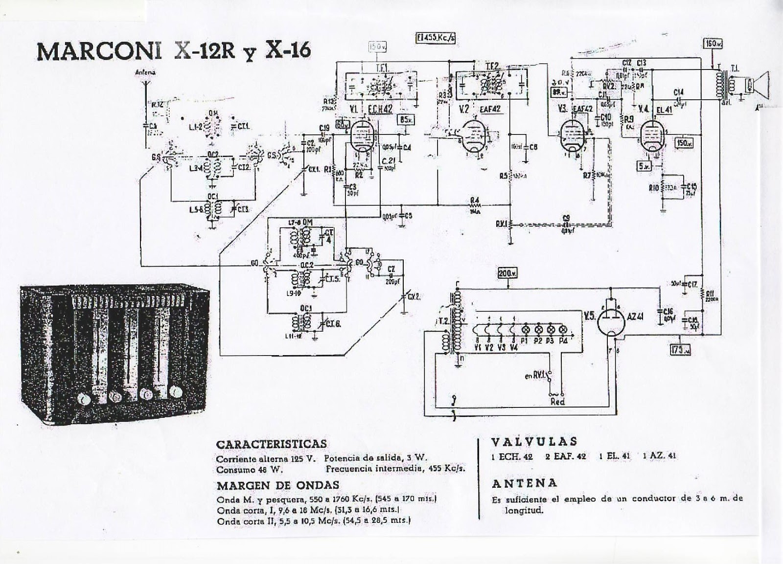

I wish you could provide me with an Invicta 329 old radio scheme. Thank you.

radiosantiguasvalvulares
Hello you can upload a photo or list of valves, if it is a valve, there we can help you, regards
paco gomez2015
List of valves is:
ECH49, EAF42, AZ41, EAF42, EL41
Take these five valves.

Locally manufactured radios are not well known abroad. The radios must be located by the set of valves it has, and thus find a compatible circuit for the repair of the receiver.

hello this diagram can help you, the values ​​between one diagram and the other with the same valves are not very different
